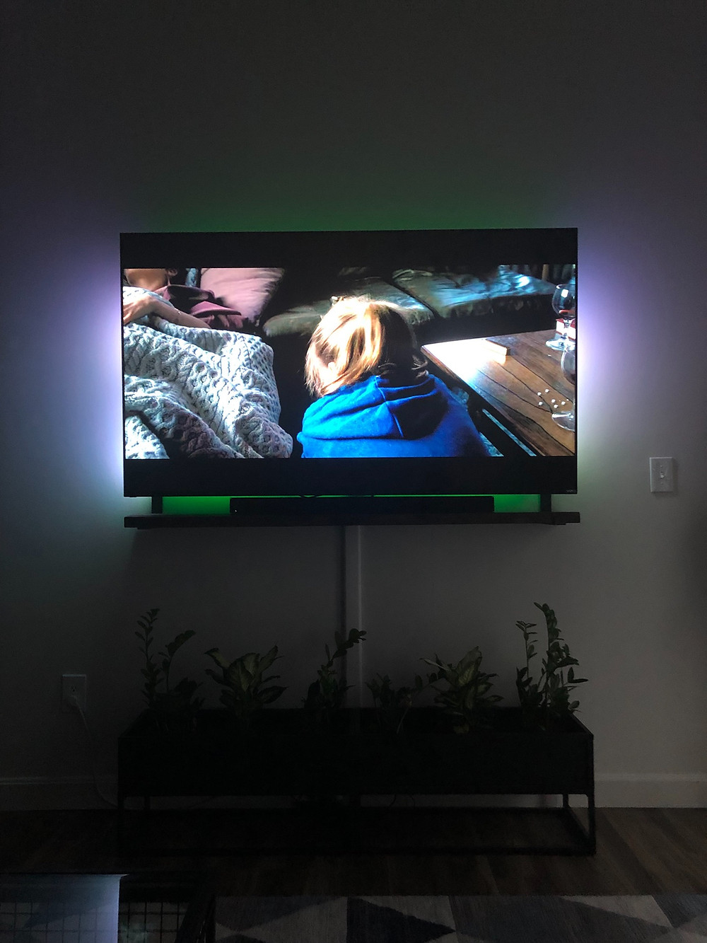

    Black bar auto refill doesn’t work
    in General Discussion
    Does anyone else have issues with the black bar auto refill not working when watching a movie? Not sure if this has anything to do with Dolby Vision issues and hopefully the splitter solves it.…the lights just emit a neon green, same goes for when the screen is black

    I gad the same problem but I was using a 4x2 hdmi splitter and had it connected wrong which gave me the green light on top and bottom. I had to connect the TV hdmi into the output on the splitter and the additional output into the input on the Neo 2.0. The output on the Neo 2.0 is not being used. I now have 4kUHD and HDR with the colors synced around the whole screen now

    ^ this solution also worked for me

    I have the same problem

    Please try to plug out all connections and reconnect them, please noted that plug in the power is the last step.
    bleahy20
    Feb 03
    @Lytmi I’ve tried that multiple times. I was told via email that the firmware had to be and would be updated to work with Dolby Vision and HDR

    I am having the same problem. The solution suggested above using a 4x2 HDMI splitter did not work for me. Is there any other solution for this? It's pretty much useless without getting the effect on the top and bottom of the TV. I really would like this to work.
