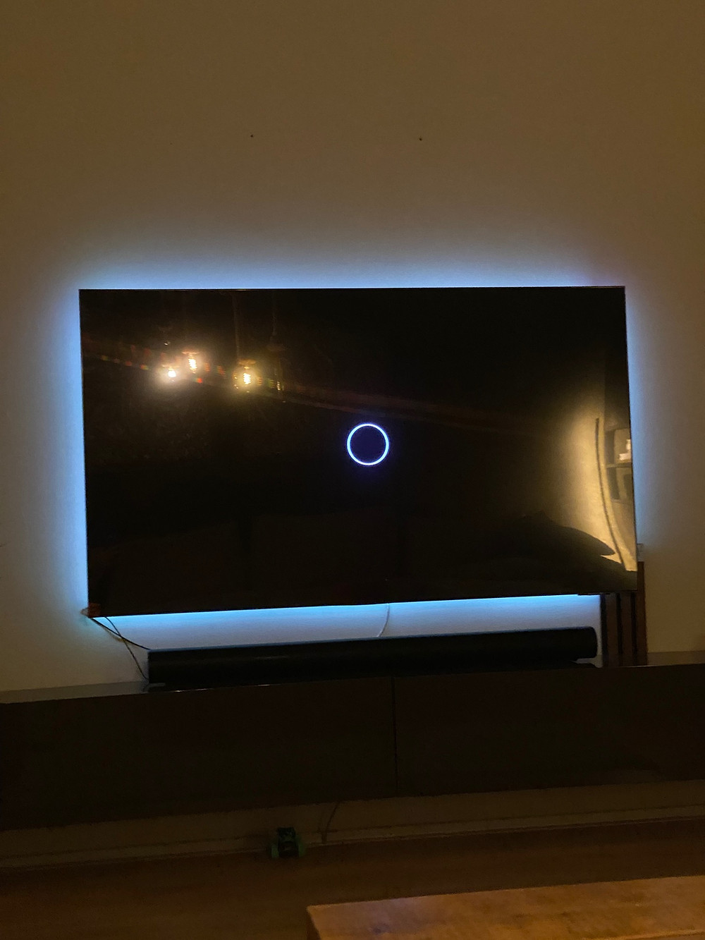

    I got my neo 2.0 almost 2 weeks ago but I‘ve not managed to get the quality out of it as I would expect. I tried better HDMI cables but this seems not the issue. Major issues:
    1. black screen of the dolby vision demo video gives green led lights. This happens when playing in HDR with the Dolby vision app on Apple TV. When playing other 4K videos which are non HDR this is Mostly not the case.

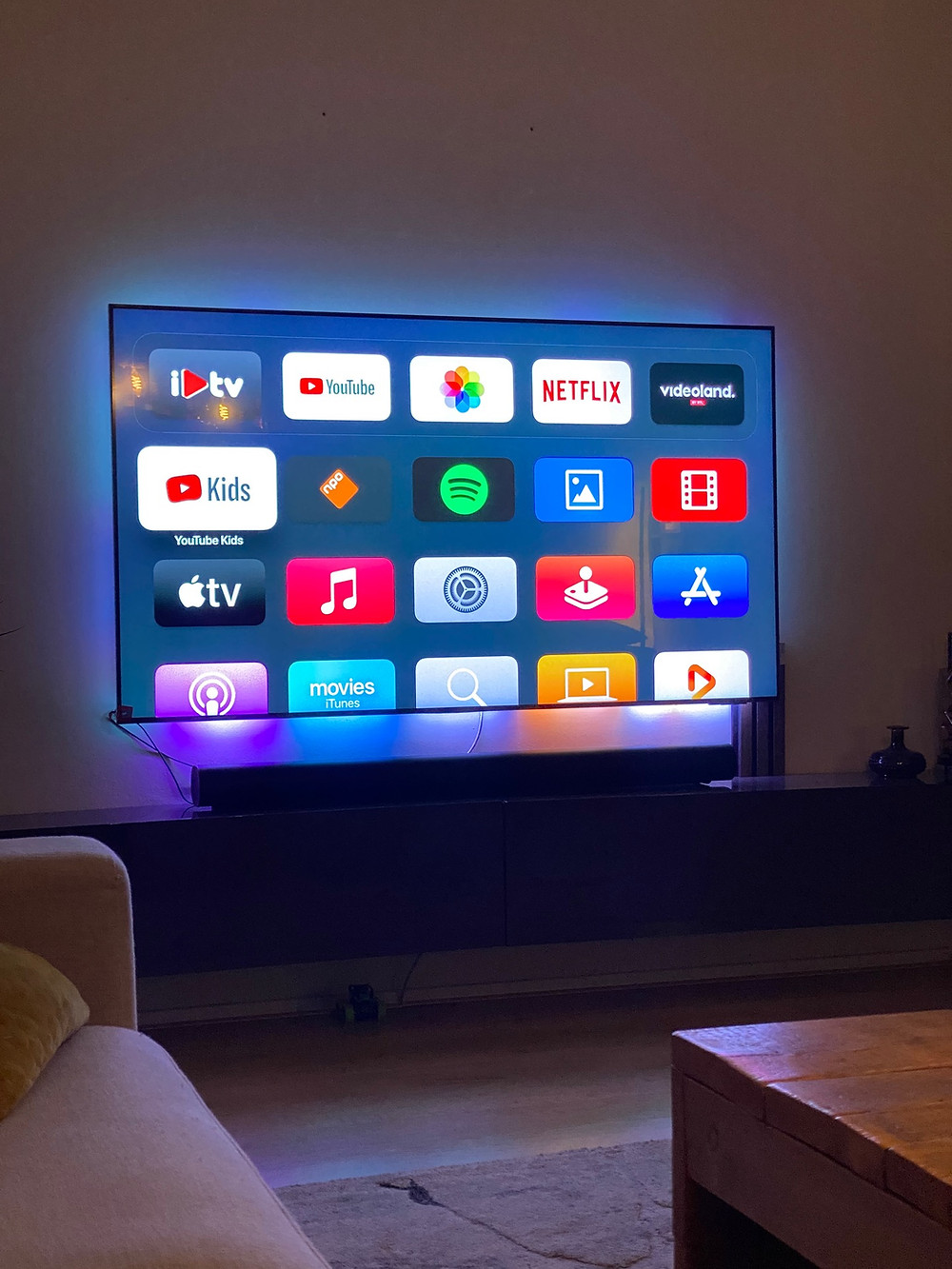

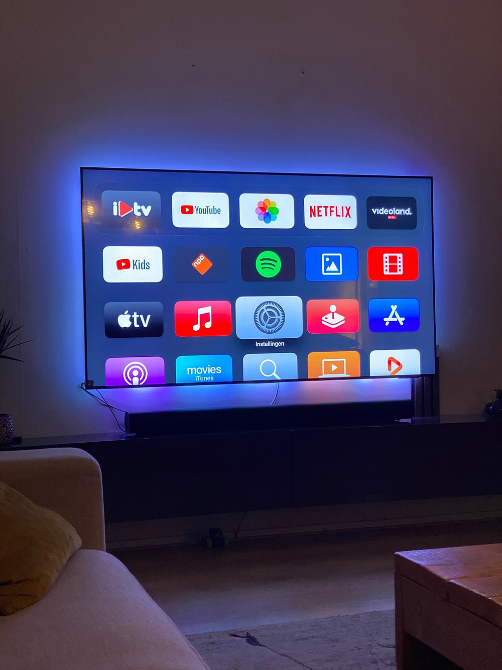

    issue 2: check below pictures of SDR vs HDR. SDR gives far more color to the LED strips then HDR. It’s clearly visible in the bottom of the screen.
    SDR:
    HDR:

    HDR, DV and SDR material are using different colorspaces and gamma curves. It looks like the conversion is wrong or not implemented. I would say the led stripes prozessing must be done in SDR BT.709.
    SDR ambiligt looks really great wit this box. But it never supports HDR or DV with accurate color processing 😂😂.
